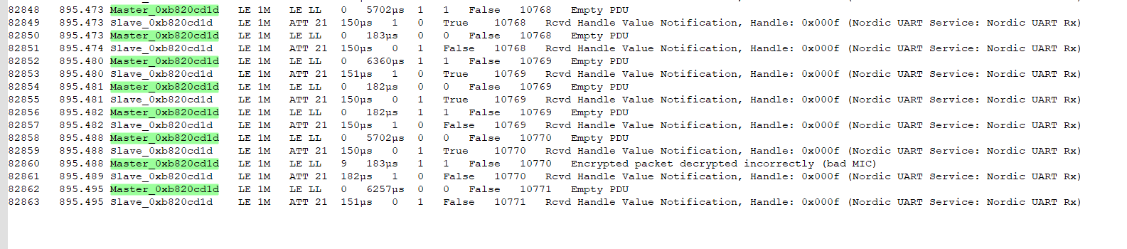

We logged the traffic in Wireshark for this data streaming when triggered from both nRF Connect and Python. The pictures look as follows:
NRF CONNECT and nRF52840 USB dongle:

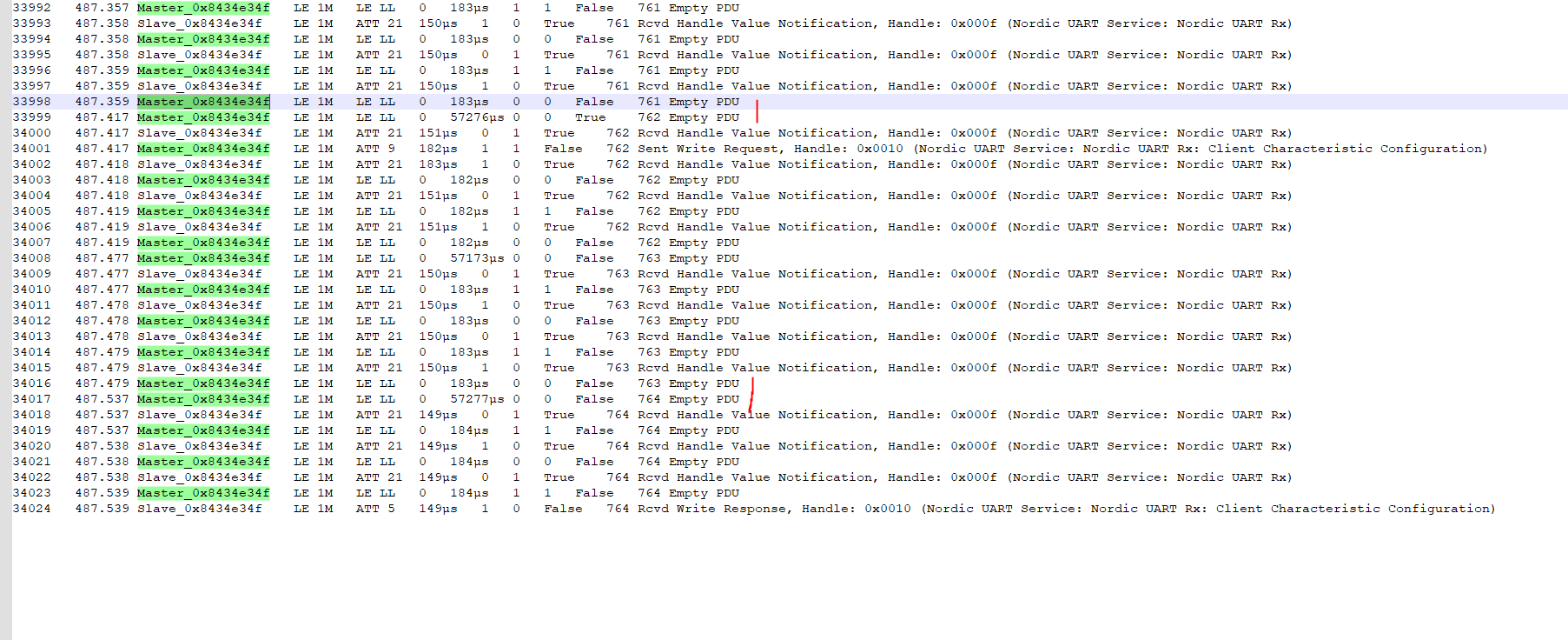

3rd-party (or built in laptop BLE) with Matlab or custom Python script:
As you can see, in the second picture, there seem to be extra transactions taking place involving the link layer. The time between the two events marked with a red vertical line is ~50ms!!! This ruins our data rate and severely cripples the performance of the device.
Unfortunately we do not know who is at fault here and how to properly interpret what we see in the picture. Is the master requesting something and the slave device does not answer in a timely manner? Or, is the slave maybe failing to send another notification and the master sends some confirmation again?

    This from nRF5 SDK? The ble_app_uart example? If yes, try increasing  NRF_SDH_BLE_GAP_EVENT_LENGTH in sdk_config.h to a higher value. Try setting it to 100. The BLE connection interval is much higher in the log_pyt_3_ISSUE.pcapng , so for max throughput you want to increase NRF_SDH_BLE_GAP_EVENT_LENGTH so that it at least matches the connection interval you see here.
