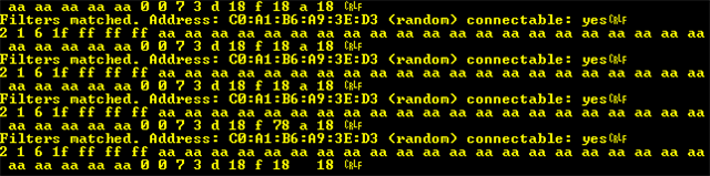

  • Hi Ashish,
    I attached here the code I modified to show how extended advertising can be scan. I based on the central_hr_coded but the advertising is on 1Mbps not CODED PHY. You can testing using nRF52832 dk.
    You should see something like this in the log of the central:
    Note that nRF Sniffer and many phones can scan for extended advertising. Please check your phone capability.
