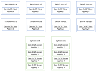

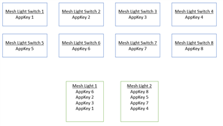

I want to be able to configure my nodes (assign AppKeys) from my own mobile application. I would like to know if it was posible to provision the nodes from the nordic app (as I always do) and then configure the nodes adding, deleting or changing the AppKeys from my own mobile application. You may wonder why self configure, when there is nrf mesh provisioning mobile app, but it is necessary in order to make an interface for the customers. I have represented a "graphic" example with light/switch from nordic sdk what I want to do.
For example, the app I would like to developed should be able to change Mesh Light Switch 6 controlling Mesh Light 1 to control Mesh Light 2

    I have one comment regarding your figure. A mesh model, such as the server model in "Mesh Light 1", is assigned to one application key, not multiple. Typically, with the set of nodes that you have there, you would set one application key for use with "Mesh Light 1", and use that application key for all switches controlling that light. For addressing, the light would typically subscribe to a group address, and the switches controlling that light publish to that same group address.
    Further, unless there are any security reasons for using different application keys for the two lights, all of the lighting would use the same application key. The application key is intended for one "application", where "lighting system" can be one such application, "door lock" another, and so on. The purpose of the application keys is to divide the systems into different security domains, so that physical tampering with one device from one system doesn't grant access to the functionality of other systems running over the same mesh network. There are scenarios where one might consider using different application keys for different lights, for instance for a hotel where for instance each room can get its own application key to prevent the guest in one room from tampering with the nodes of other rooms.

    "I have one comment regarding your figure. A mesh model, such as the server model in "Mesh Light 1", is assigned to one application key, not multiple. Typically, with the set of nodes that you have there, you would set one application key for use with "Mesh Light 1", and use that application key for all switches controlling that light. For addressing, the light would typically subscribe to a group address, and the switches controlling that light publish to that same group address."
    Answer:
    It is true. I have corrected that representation
    Basically I want the client to decide, through my custom mobile application, what switches to use for light 1 and which for light 2, and they can change this configuration whenever they want.
