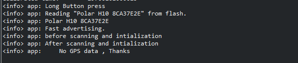

  • Hello Einar, Thanks for the reply.
    Yes, I am observing behaviour in debugging as you can see in the below attached picture.
    before the short press of a button, the Polar H10 is connected and I can see the Heart Rate in debugging, but when I short press the button, it disconnects the Polar H10 and I can no longer see Heart Rate in debugging. When I long-press the same button and call  scan_init() and scan_start(), the Heart Rate doesn't re-appear in the debug. In the below pictures you can see my disconnect functions.

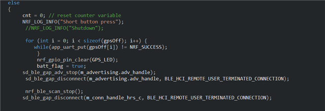

    As you can see in the above picture(which is for short press) I am calling two disconnect functions one for scanning and the other for advertising. The scanned device(Polar H10) got disconnected and the advertised device(Mobile App) doesn't, even I change the ble_adv_on_disconnect_disabled == true in ble_advertising.c as per your suggestion. Maybe I am not passing the correct parameter in the disconnect function for disconnecting the advertised device, please check it I am using the ble_app_hrs_rscs_relay example.

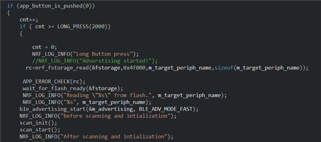

    The below picture is the code for a long press of the same button where I want to wake the device that is to start advertising, scanning etc and come back to normal functions(wake).

  • Hi Sami,
    Looking at your second code snippet, let me clarify one thing. sd_ble_gap_disconnect() is used to disconnect connections. It is wrong to try to use this to stop advertising or scanning. To stop advertising, you call sd_ble_gap_adv_stop(), and do stop scaning, call nrf_ble_scan_stop(), as you do. So remove the two sd_ble_gap_disconnect() calls you have there.
    However, if you have a connection you want to terminate you should call sd_ble_gap_disconnect() with the connection handle of the connection (which you got from the BLE_GAP_EVT_CONNECTED event). I do not see that anywhere in your code snippet, but that is what you need to do.
