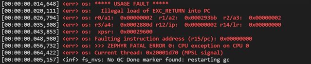

Application suddenly stopped building
I'm having an extremely annoying problem. I have an application that uses Nordic NUS service.
(1) I created it from the peripheral UART example for NRF52-DK, and adapted it for use with NRF52805 (removed non-exiting buttons and LEDS)
(2) It was compiling and flashing fine yesterday noon. Last night I tried to add built in die temperature read, and noticed that my app doesn't compile.
(3) I removed the new code, and now my app builds but hangs (reset on startup I think) I enable the terminal and see the following error:
(4) I then tried to start from scratch, i.e. I thought this might have to do with my NRF connect version.
     (a) I installed 1.9.1 (was working with 1.9.0)
     (b) I added the peripheral_uart example
     (c) I notice that it no longer lists nrf52805 as supported board, but I again removed non-existing hardware
     (d) The board now hangs on "Starting Nordic UART Service Example" (infinite loop repeats)
(5) Looking with a debugger line by line it seems that the command that hangs, compared to the 52832 build is bt_enable(NULL). Any insights?
Attached is the main code

What is going on ??!!
Please help,

  • matangk said:
    Did you use my code snippet
    No. But I just tested your code(main.c), it advertised, I was able to connect. But I got a error when I tried sending data from the phone to the nRF52 with your code.
    Do you have LF crystal on this module? If not, try setting
    I will check out the sample you attached.
  • Well. I just had a very confusing half hour. I looked for another sample with BT that might compile on nrf52805. I found the peripheral button-led. I built it for nrf52dk_nrf52805, ant programmed the DK.
    This is on my old PC where nothing was working before. Voilla. The btl sample app works.
    "Huh" - I thought and now again tried to build a fresh sample of peripheral uart, on sdk 1.9.1. I programmed my NRF52-DK AND IT WORKS.
    HOW CAN THAT BE?? I didn't do anything different.
    Not only that, now ALL THE FAILED SAMPLES now work fine.
    Is it possible that there is some non-volatile area that got corrupted and writing the btl app fixed it??
    I'll be happy to know what's going on as two work days were just put into this.T
    hanks
    Difficult to say for sure, but that might be the explanation. If you run into this again in the future, try to do a full erase of the flash:
    nrfjprog --eraseall
