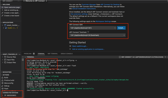

Following the update of my mac (M1) in Monterey, i can no longer flash programs on my board (everything worked under Big Sur).
I got the error JLinkARM DLL load failed.
I uninstalled everything to have a clean base:
nRF SDK 1.7
nRF Connect 3.10
Latest version VS Code (intel version)
And JLink (intel version) 7.60f
i've tried ARM versions of VS Code and JLink as well, nothing works.
Any ideas ?
Thank you!

  • Thanks Charlie for your help,
    On the nRF9160-DK it worked but not on my custom board (JLink fail).
    I downgrade nRF Command tools to 10.5.3 and i can flash again.
    Maybe the Arm64 binaries have an impact.
    So for me, M1 Monterey and custom board, a setup that works:
    nRF SDK (like you want)
    nRF Connect, last version
    nRF Command Tools 10.5.3
    VS Code (intel version) and JLink 7.58b (intel version)
