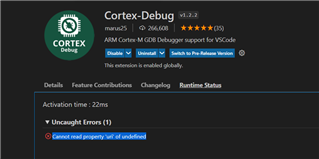

Hi
I just started using VS with Nordic and keep getting the error below can someone please assist.
Debug session did not terminate cleanly TypeError: Cannot read property 'uri' of undefined undefined. Please report this problem.
Regards
David

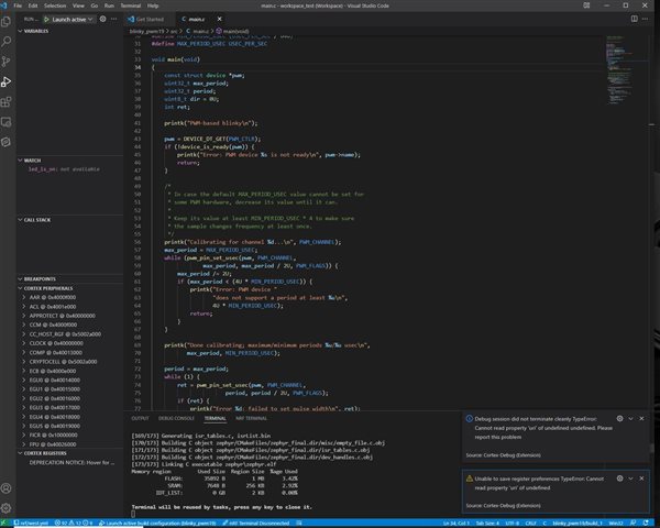

  • HI
    Yes I am using Visual studio with Nordic connect project Blinky , I can run the debugger but if I stop it to go back to the editor,
    this is the line that comes up in the terminal. Then just stays in the debugger environment .

  • David, I tried running the Blinky sample and debug it using the nRF Connect debug feature, on a nRF52840 DK.
    Here is the output from Debug Console
    Launching GDB: "c:\\NordicSemi\\v1.9.1\\toolchain\\opt\\bin\\arm-none-eabi-gdb.exe" -q --interpreter=mi2 "c:\\Temp\\Support\\286021\\blinky\\build\\zephyr\\zephyr.hex"
    Set "showDevDebugOutput": true in your "launch.json" to see verbose GDB transactions here. Helpful to debug issues or report problems

    I'm not able to reproduce what you are referring to.
    Can you please open the Command Palette in VS Code and type in nRF Connect: Generate support information, and please provide the output here.
    Thanks.
    Øyvind
  • HI
    This is a screen shot of the error when I click on the red square stop
    Will send other info shortly

  • David, thanks for providing this screenshot. I see that the error is generated by the Cortex-Debug extension which is not ours, but installed by our extension I believe. Not sure why I didn't get the same pop-up, but I do have the same error reported by the Cortex-Debug extension.
    I'm investigating and will get back to you as soon as I have more information.
    Øyvind
