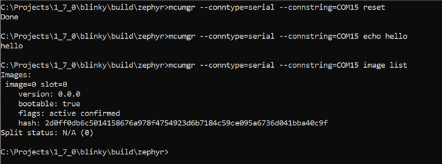

I am trying to upload an image into my nrf52840 dongle (running smp_svr over cdc) using mcumgr image upload command but it resets the dongle. All other command like image list, echo, reset works fine. Below is the snap shot of working command.
mcumgr image upload command snap shot which is not uploading iamge and dongle gets reset
