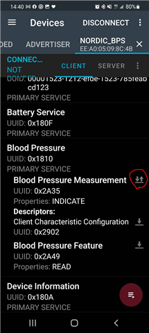

Hi All,
I want to port BPS to my custom project, I encountered the problem as the title.
When I connect and trigger the subscribe like this picture.

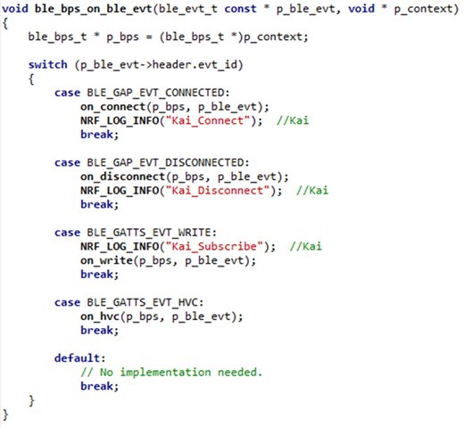

My project will not execute 【case BLE_GATTS_EVT_WRITE】 will be disconnected,like this picture.
Here is my project,please help me to take a look.

    If anyone with the same question can refer to my answer.
    Research purpose => Add Blood Pressure Service to the project, do not use Peer Manager.
    Problem => BPS does not respond and disconnects when triggering Subscribe.
    Solution => SEC_JUST_WORKS should be changed to SEC_OPEN.
     // Here the sec level for the Blood Pressure Service can be changed/increased.
        //bps_init.bp_cccd_wr_sec    = SEC_JUST_WORKS;  // Nordic programming
        bps_init.bp_cccd_wr_sec    = SEC_OPEN;  // if donot use Peer Manager,you should use this code.
        bps_init.bp_feature_rd_sec = SEC_OPEN;
