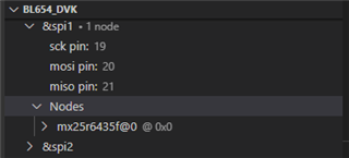

  • Thanks for the response,
    I just tried putting that line in, but it throws "parse error: undefined node label 'mx25r6435f'" when I try to build. I tired adding the "@0" as well. Using "/delete-node/ &spi1;" is recognized but does not seem to solve the issue. In the device tree the node does show up however, I have tried manually disabling spi1 as well, but no luck. Here is my .conf and .overlay files.

    I have not tried this on a nRF52840dk, does that board have a spi flash on it?
    Sorry for that, it seems that this peripheral/node isn't required to delete.
    This is the overlay and conf file that I placed in the board folder for the bl654_dvk:
    bl654_dvk.conf
    bl654_dvk.overlay
    The pin-outs are edited to match the nRF52840-DK, as I do not have this module at-hand.
    This ran as expected when flashed:
