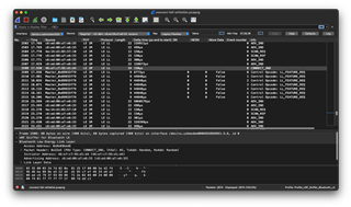

  • I see. This should work, then. Can you make a sniffer trace? It would be interesting to see how this looks like on air, and if the Android device actually attempts to connect or not. Also, if you have any other central you can test with, that could also be good.
  • The sniffer trace seems to show that Android is trying to connect to the device, but the device doesn't respond. In fact it doesn't send any packets at all for ~5s.
    Active scanning responses do come back though, even for centrals not on the whitelist, but maybe that's correct?
    This is the expected behavior when using whitelist and the device is not in the whitelist. I think I see the issue though, which I overlooked earlier. If the code snippet from your original post is complete in lacks an important part, which sis setting the identity list. This is the list of IRKs used by the SoftDevice to resolve the identities of peers using privacy (like Android phones). So even if you get the IRK from the bonding procedure, I suspect that you do not actually use it? I suggest you refer to an SDK example, for instance examples\ble_peripheral\experimental\ble_app_cgms\main.c, and see how that implements the identities_set() function. You need to do the same in your application.
