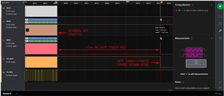

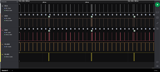

The image above shows one sensors sampling at 1mS and the other at 10mS intervals as expected.
Now this is where the strangeness happens, every so often my spi message queue completely fills (10deep) . I tracked this down to an issue with the app timer instances that periodically add messages to the spi message queue. What seems to be happening is that I will get no timer IRQ calls for about ~1Sec. After the 1 second I seem to get all the missing calls that were missed at once. This completely fills my spi msg buffer, at which point my app hits a breakpoint due to msg queue being full.
