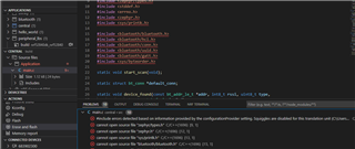

I am trying to work with peripheral LBS sample. i flashed this code on nRF52840 dk.
i am using nRF52840 dk only . I am not using dongle .
i have android based mobile with 'nRF connect for mobile' app installed.
when i turn on the app in mobile with nRF dk power on , the nrf dk (Nodic-LBS)is not listed in scanning window of mobile.why dk kit and mobile are not getting paired.
file:///C:/Users/deepthi.hs/Downloads/Capture.PNG
Errors showing in problem window while doing build and flash.
Which standard files to install to include these .h files?
These files should be included in the nRF Connect SDK installation. How did you install the SDK?
I recommend watching our nRF Connect for VS Code tutorials on YouTube to learn how to get started. There you will learn how to install the SDK and toolchain, as well as how to create, build, and flash applications.
hi Marte,
I could clear those errors listed in problem window.
then, i build and flashed again. But still Nordic_LBS was not visible when tried to scan througrh nRF connect for mobile app.
Hi Marte,
Yes, now i can see Nordic-LBS in scan list of my mobile.
