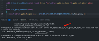

i want to use P0.31 as gpio interrupt pin,
anyone know how to do it ?
void device_irq_callback(const struct device *port,struct gpio_callback *cb,gpio_port_pins_t pins)
void init_gpio_interrupt(void)
	#define GPIO(id) DT_NODELABEL(gpio##id)
	const struct device *gpio_31 = device_get_binding(DT_LABEL(GPIO(31)));
	// const struct device *gpio_31 = device_get_binding(DT_LABEL(DT_NODELABEL(gpio31)));
	gpio_pin_configure(gpio_31, 31, GPIO_INPUT | GPIO_PULL_UP);//IRQ_GPIO_FLAGS
	gpio_pin_interrupt_configure(gpio_31, 31, GPIO_INT_EDGE_BOTH);
	struct gpio_callback callback;
	gpio_init_callback(&callback, device_irq_callback, BIT(31));
	gpio_add_callback(gpio_31, &callback);

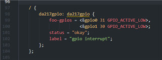

if config to overlay file like follow,it show unkonw label.

    thanks for reply,
    2133.nrf52840dk_nrf52840.overlay
    	const struct device *int1GpioDevice = device_get_binding(
    		DT_LABEL(DT_PHANDLE(DT_NODELABEL(da217gpio), int1_gpio)));
    	int int1Pin = DT_PROP(DT_NODELABEL(da217gpio), int1_pin);
    	gpio_pin_configure(int1GpioDevice, int1Pin, GPIO_INPUT | GPIO_PULL_DOWN);
    	gpio_pin_interrupt_configure(int1GpioDevice, int1Pin, GPIO_INT_EDGE_RISING);
    	gpio_init_callback(&callback, device_irq_callback, BIT(int1Pin));
    	int ret = gpio_add_callback(int1GpioDevice, &callback);
