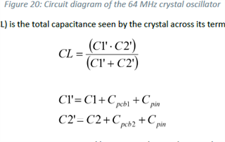

  • We used 32Mhz +-20ppm 12pF crystal and 12pF for C1,C2  before we found that problem.We realize we may use the wrong parameter for C1,C2  after you mentioned the load caps.So we used 18pF for C1,C2 after we calculated the load caps with load caps equation(according to the figure 20 ).
    18pF may not be the best parameter for C1,C2 as we not sure value of PCB cap,we assume PCB cap is 2pF.But after that  the samsung cellphone could scan and connect our product.

  • For a crystal with CL = 12 pF, you can use 18 pF caps. Calculate as follows:
    Ccap = CL *2 - Cpin, where Cpin = 4 pF.
    Round down to the nearest standard value to account for the PCB capacitance. The PCB capacitance is the order of  ~1 pF.
    Unfortunately, there's no SW fix for this on this device.

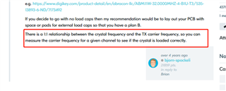

    We want to make sure it won't happen again, so we plan to test 2.4G carried frequency in broadcast channel with frequency spectrograph for every product. Can  frequency spectrograph detect the  frequency offset of 2.4G carried frequency?
    The screen shot mention "relationship between crystal frequency and Tx carried frequency is 1:1" . It means Tx carried frequency offset 100khz if crystal frequency offset 100khz, am I right?
    If it's true, we guess we can tune  crystal frequency to fix the  frequency offset of 2.4G carried frequency.can we do that?
  • You don't need to test each and every device this way but it's a good way to test the prototype for the correct load cap value. But you should test the radio on each product to make sure the load caps are correctly mounted etc. Thus can be a simple connection test.
    The offset in the 32 MHz crystal frequency scales with the ratio between the carrier and the crystal freq. The difference in ppm is the same, but not Hz. For example, If you have a 30 ppm error in the 32 MHz clock, the carrier will have the same offset.  This corresponds with a 960 Hz offset for the 32 MHz clock but a 72 kHz offset for the carrier.
    The frequency of the crystal can only be changed of you change the load caps for the crystal. There's no way to change it by SW.
