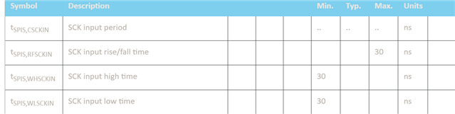

    Also looking at this chart
    The minimal times for one clock cycles =
         (Rise time + high time + fall time + low time) =  30ns + 30ns + 30ns + 30ns = 120ns which is a maximum of 8.33MHz.
    If the rise and fall time of the source clock from SPI master is less than 30ns, then you can get higher speed from my above calculation.
