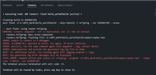

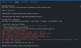

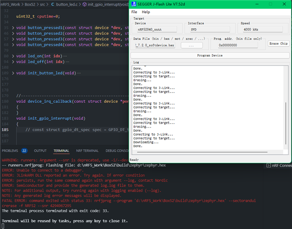

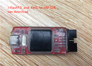

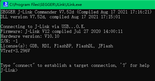

NCS1.9.1 VS Code download error
NCS1.9.1, nRF52840 chip,  Windows10 X64, VS Code, JLink V10 Model,
i've connect pins CLK,DIO,GND,3.3V,
now:
J-Flash download(hex) work well,

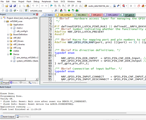

Keil5 IDE download(nRF SDK) work well,

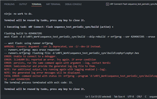

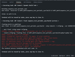

but VS Code download(NCS) error,   i don't know what happened.
tips:     VS Code download to nRF52840DK will be OK (no use JLink V10 Model).
thanks
Best Regards

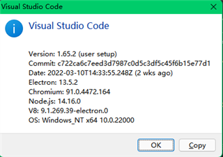

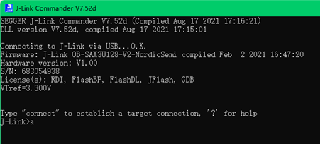

    Kindly make sure that you have downloaded the latest version of nRF Connect extension for VS Code. Also, download a J-Link Commander V7.20 or above.

    now  SES can download.
    only VSCode can't download.

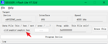

    thanks for reply.
    The problem remains. I can only download it through J-Flash.

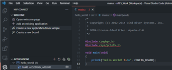

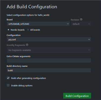

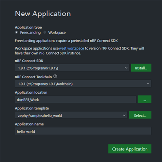

    Sorry for repeating a few questions. I would like to clarify some stuff.
    You are using the nRF52840DK right? (please verify tat it is not a nRF52840-PDK)
    And you are trying to do the basic hello_world sample onto the nRF52840DK?
    Have you tried using west? Does it work well when trying with west?
    Also, could you try shifting the folder "nRF5_Work" to d:/Programs/nRF5_Work and then try again?
    -Priyanka
    yes, i step  two,  and i use nRF52840-DK,not PDK.

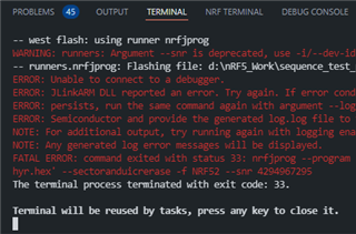

    Could you run the command
    nrfjprog --program "d:\nRF5_Work\hello_world\build\zephyr.hex" --chiperase -f NRF52 --log
    and attach the log here as reply?
    -Priyanka
