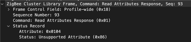

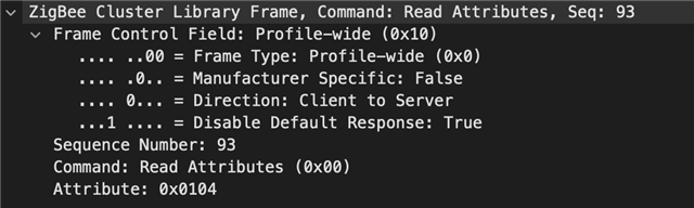

I can query *most* of these attributes from the ZC (zigbee2mqtt dev console).  But some, like ZB_ZCL_ATTR_DIAGNOSTICS_MAC_RX_UCAST_ID or ZB_ZCL_ATTR_DIAGNOSTICS_MAC_TX_UCAST_ID, return UNSUPPORTED_ATTRIBUTE.  I verified this in wireshark:
I don't see any pattern to it; when looking at the ZB_ZCL_DECLARE_DIAGNOSTICS_ATTRIB_LIST the failing attributes are somewhere in the middle of the list, not at the beginning or end.  ZB_ZCL_ATTR_DIAGNOSTICS_MAC_TX_BCAST_ID works but the next attribute ZB_ZCL_ATTR_DIAGNOSTICS_MAC_RX_UCAST_ID doesn't.
