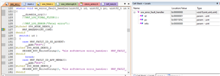

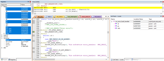

    Does the program enter the HardFault_Handler() function, or does it go into the user specified fault handler that is registered when you call sd_softdevice_enable()? Could you include a screenshot showing the call stack and cpu registers after you have entered one of these fault handlers?
    Vidar
  • hi,
       it go into the user specified fault handler,As shown below.
    If  need any more information let me know.
    Thanks for confirming. So it seems like the issue may be that the Softdevice is not adding enough margin to account for the additional clock drift from the RC oscillator. The LFSYNTH is derived from the HF crystal oscillator (HFXO) and is therefore offering a better clock accuracy. I will discuss with the team to see if they agree with my assumptions and get back to you.
