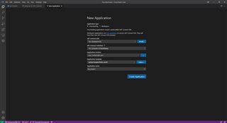

With VS Code it's easy, because you can create an application using a sample as an application template, but it looks like with the SES there is no such possibility.

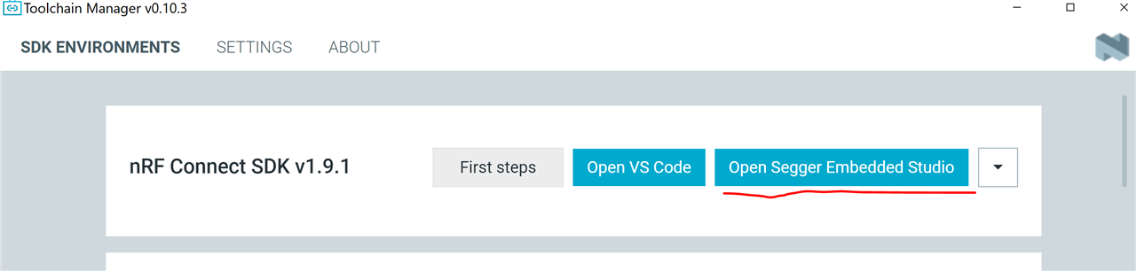

    In order to create a new sample in SES, you can open the nRF Connect for Desktop Application on your PC, navigate to "Toolchain Manager". Then go to your required version, say you want v1.9.1 then select the "Open SEGGER Embedded Studio" option beside the version:

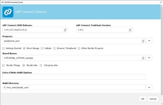

    This will take you to SES and there, you can navigate to "Files" in the top left corner and select "Open nRF Connect SDK Project...". This will take you to the page where you can select your sample, DK and build details.

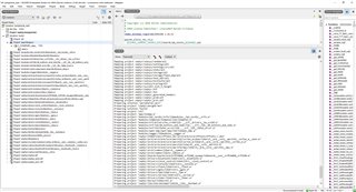

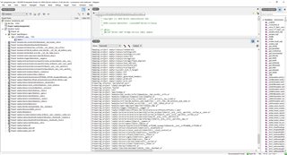

  • Yes, I can compile, but the application sources remain in the SDK. Just the build directory is created. Also, the "add new file to CMakeLists.txt" doesn't seem to work. I'd like to be able to put just the application code to a version control repo - not the whole SDK. Also, I don't want to break the samples.
  • In the VS Code version, it's easy, when you can give the project name and application location (the application really goes there) and give a sample as a template.
