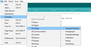

For reference, this is how I answer one of the above questions in the Arduino IDE:
Now that took approximately 5 seconds to locate compared to the hours it would have taken with the Thingy91.

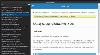

    As for finding samples we recently introduced a new feature in VSCode to allow you more easily to search through the various samples available:
    Possibly the ADC sample was not the best one to highlight as this is not designed for Nordic devices unfortunately (as mentioned in the readme), there is a description of how to add ADC support to a Nordic example here.
    In order to see only the samples supported by the Thingy91 you can filter on the board:
