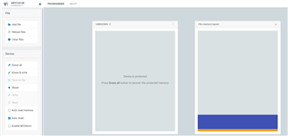

I have created software on the evaluation board nRF52840-DK.
When I write it with s140_nrf52_7.2.0_softdevice.hex, the evaluation board starts BLE advertise output when it is booted.
I tried to write that software to nRF52840 on nRF9160-DK.
I switched SW10 on the nRF9160-DK to nRF52 to write the software, but it does not start the advertise output.
I have confirmed that when I write the Sotfdevice it shows "Device is protected", is this related?
I have also confirmed that software created for the nRF9160 that does not use softdevice can write to and read from the nRF52840 on the nRF9160-DK when built with the configuration for the nRF52840.
Thank you.
    Yes, that may very well be related.
    Do you have nRF Command Line Tools installed? If so, you can use the command "nrfjprog --recover" when the debugger is connected to the nRF52840 to turn off the readback protection.
