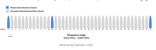

    For BLE protocol 2453 MHz frequency is not for advertising. Channel 37 (2402 MHz), channel 38 (2426 MHz) and channel 39 (2480 MHz) for BLE.
    It seems like the device you are tying to scan the information from is not using BLE protocol. May be it has some other protocols. Sorry we can not help you with reverse engineering other protocols and sniffing the data as we do not know what has been used. If the data is secured or not. Theoretically what you intend to do is possible; might be some other forums would be more suitable for ask.
