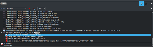

    Also, I have another issue with reading large file (234MB) from the SD card, I can only read 220000 bytes from the SD card and when I am trying to increase the FILE_SIZE_MAX then 220000 bytes or when I change static uint8_t file_buffer[FILE_SIZE_MAX] (which is storing the read data from SD card) to uint16_t, then I am getting an error as shown in the attached snippet. how can I read the 234MB file from the SD card?
