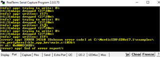

  • Hi Kei,
    I tried your code here and don't see the same problem. I attached the code here. The write worked for 159 records and the it stops. 159x64 = 10176 bytes matching with the roughly 12kB you reserved for the fds (there is some headers on each of the record).
    Note that you should do a flash eraseall before you test so that the previous database will be cleaned.
    In addition when you declare your data to be written to fds they should be word aligned. I added __ALIGN(4) into:
    __ALIGN(4) static T_FDS_LOG_DATA v_fds_log_data_write;
    Here is the log I get :
    ble_app_hrs_fds.zip
