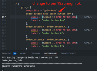

NCS1.9.1, nRF52840DK, Windows10 X64, VSCode,
in file overlay:
thanks

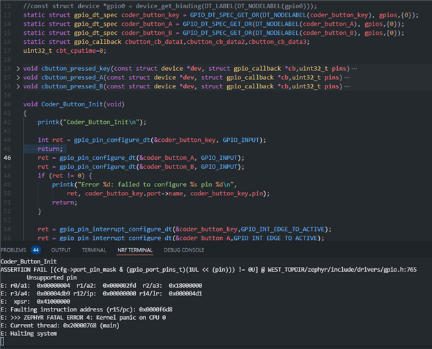

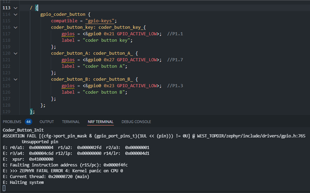

in file overlay:
thanks
Best Regards
For P1.x, you can refer to the pins as (pin number + 32).
For eg,
P1.01 can be &gpio0 33, i.e. 32+1 = 33
Pin 21 is just P0.21 and this is used for external flash memory and this is what causes the problem.
I would suggest you to kindly take a look at the Beginners Tutorial for NCS which has 4 parts and it is also described how to create overlay files.
There is also the Zephyr overlay guide.

why change to 19 will running ok?
becase the config CONFIG_ZTEST=y
delete it or CONFIG_ZTEST=n.
Another reason is that the overwrite file does not support uppercase letters.
