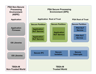

  • Security by Separation (Secure and Non-secure)
    Applications running on microcontrollers are made up of multiple different parts.
    These parts use different peripherals, modules and areas of flash/RAM.
    To increase security, the application can be separated into two different parts, with a "wall" between, referred to as Security by Separation.
    One side is called Secure and the other is called Non-Secure. See figure below, found under "Trusted Base System Architecture for M" from the Arm Developer site for Platform Security, Figure 2. You can also read more about the concept at this link, in chapter 3.1 Security by Separation and onward.
    To build with this separation, Secure Partition Manager (SPM) or TF-M needs to be added to the application.
    When building for boards with the postfix "_ns",  a SPM child image is automatically added.
    When building for boards with the postfix "_ns" and using "BUILD_WITH_TFM=y" configured,  a TF-M child image is added instead.
    The secure partition is often refereed to as Secure Processing Environment (SPE).
    The non-secure partition is often refereed to as Non-Secure Processing Environment (NSPE).
    A common misunderstanding is from the naming of the builds. For example from Working with nRF9160 DK:
    nrf9160dk_nrf9160 for firmware in the secure domain
    nrf9160dk_nrf9160_ns for firmware in the non-secure domain
    If your firmware is in the secure domain, everything in your application will be in the same domain, and you will not have Security by Separation.
    If your firmware is in the non-secure domain, it will be separated from the secure domain, and you will have Security by Separation.
    Therefore, it is more secure to build for non-secure boards, such as nrf9160dk_nrf9160_ns.

  • I think the naming Secure Domain and Non-Secure domain can be misleading sometimes.
    In the picture attached to the first reply, at the bottom the parts are called Trusted World and Non-Trusted World. I think this conveys the meaning better.
