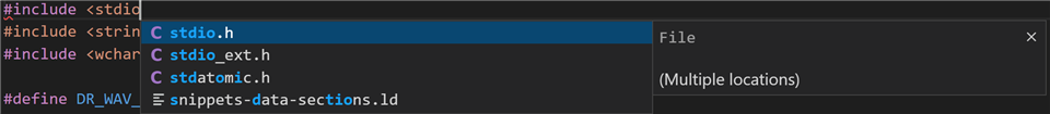

And VS Code will now recognize that there are two stdio.h available, one from zephyr and one from standard C:
But still, when trying to call dr_wav_init_file() in main.c, I get the following build errors:
