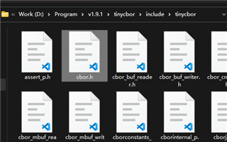

build error fatal error: tinycbor/cbor.h: No such file or directory.
The file of cbor.h is exists.

    The path to the cbor.h looks correct. It might be that something had gone wrong while downloading nRF Connect SDK.. Could try reinstalling the SDK from the toolchain manager and try once more.?

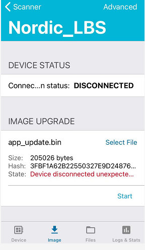

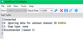

    nRF Toolbox whilt  \build\zephyr\dfu_application.zip, app crashed.
    nRF Connect Device Manager with  \build\zephyr\app_update.bin, got logs:
