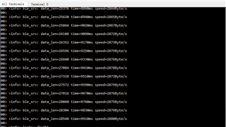

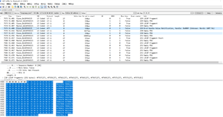

Below is the bag I grabbed, s=8
Test speed

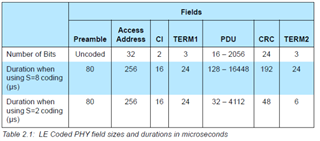

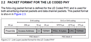

access address + ci + temr1 + pdu(header+payload)+ crc + term2 = 32bit+2bit+3bit+(244+3+2+2+2)*8*8bit+24bit*8+3bit*8 = 16445bit
speed = 16445bit/125kbit = 131.56ms
empty packet need time
access address + ci + temr1 + pdu(header)+ crc + term2  = 32bit+2bit+3bit+2*8*8bit+24bit*8+3bit*8 = 381bit
speed = 381bit/125kbit = 3.048ms

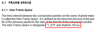

244byte/131.56ms+3.048ms+150us*2 = 1808Byte/s
But I got 2.8kbyte/s so I think i make something wrong. Can you give me some advice?

  • That time shown below is the time from "end to start"
    That means that master is not sending anything during that time. If that period is less than supeprvision timeout and the obeys slave latency, then master is allowed to send packets with that delay. You need to find out why master is delaying that packet transfer that much (assuming that nRF chip is slave here)
