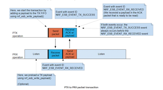

    For PRX, try to use nrf_esb_start_rx() instead of nrf_esb_start_tx().
    PS: We gave a ESB user guide here you might want to take a look at: https://infocenter.nordicsemi.com/topic/sdk_nrf5_v17.1.0/esb_users_guide.html

    I tried nrf_esb_start_rx() instead of nrf_esb_start_tx(), but the situation is still the same and the sending operation is not working.
    Isn't the operation that the module of 'NRF_ESB_MODE_PRX' transmits with nrf_esb_start_rx(), which means that the module of 'NRF_ESB_MODE_PRX' attaches the contents of the FIFO at the timing when it returns an ACK?
    If that is the case, then as I stated at the beginning, I am using NRF_ESB_MODE_PRX intentionally not to return ACK, and the method you suggest would be invalid.
    If it becomes clear that the NRF_ESB_MODE_PRX module, which does not return ACKs, cannot transmit spontaneously, we would like to consider another method.
    After all, it is impossible for a module of NRF_ESB_MODE_PRX that does not return ACK to transmit spontaneously?
    Correct.
    Correct.
    The way the PRX transmits data it to attach it to the ACK packet.
