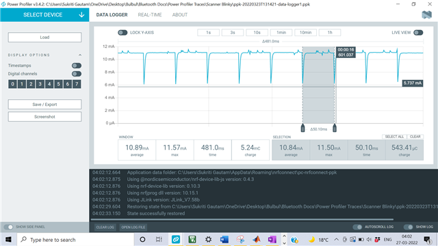

Another relevant Devzone discussion is this one, which again clarifies that the scanning device scans on a channel for the entire scan window, and it uses some time to change the radio configuration in between scan intervals. The radio is offline during this time. Thus when we set scan window equal to the scan interval, the radio is not ON all the time. This must reflect in the power profile of the scanner as well, as in this discussion. The screenshot attached in the discussion very clearly shows a dip of around 1 ms after each scan window. But, in this discussion, the 1 ms long dip in the current consumption (which is supposedly due to the channel switching activity) has been justified by stating that the SoftDevice reserves "at least" 760 μs after each Scan Window.
So now my question is that, since I encountered two contradictory statements, which one should I trust? Is 760 μs the minimum value or the worst case value?
I grew curious and checked the power profile of nRF52840 by flashing the ble_app_blinky_c example. We set the scan interval and scan window to the same value, 50 ms. The screenshots of the power profiler app have been attached here.  We did observe a dip at the each of each scan window, but as is evident from the screenshots, the dip is actually very sharp. Also, the 50 ms scan interval/ window is the difference between two consecutive dips. The current consumption begins to fall before the 50 ms duration set by us actually ends. But the discussions I came across state that switching takes place only after the scanning window ends. Then why is there a fall in the current before the window ends?
Where exactly is the switching happening here? Which point to which point in this dip can we say that the 760 μs is reflecting? Or is the switching duration smaller or larger than this specified value?
