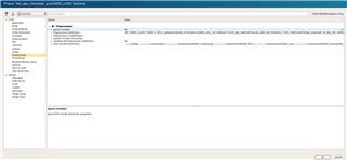

3. Right click your project and select "Options. Select "Preprocessor". Then likely you want to select the "Common" Configuration from the dropdown in the top left.
Should look like this:
Double click "User Include Directories", and set the path to the folder where your .h file can be found. The path is starting in your project directory. Click OK.

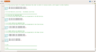

4. Add needed configurations for your files to sdk_config.h manually:
