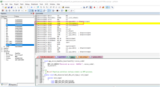

  • Hi  Edvin,
    1. I make sure I set up the correct addresses
    2. During the debug process, it is found that the program does not run to the main entrance of the bootloader
    3. I used nRF52820 module for testing
    4. Is there anything else that needs to be changed?

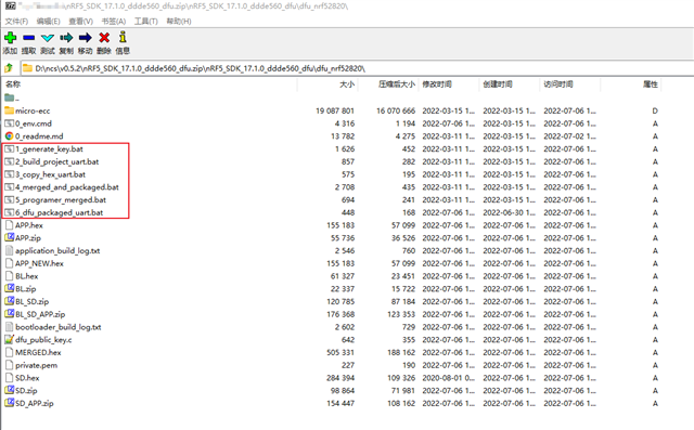

  • Hi Edvin
    I test nRF52840 nRF52832 nRF52833 nRF52810 ble dfu uart dfu OK
    example:https://pan.olib.cn/%EF%BC%887%EF%BC%89%EF%BC%9A%E6%B5%8B%E8%AF%95%E4%BE%8B%E7%A8%8B%EF%BC%88%E5%8A%9F%E8%80%97%20%E5%A4%96%E8%AE%BE%20DFU%20FDS%20AT%EF%BC%89/nRF52/nRF5_SDK_17.1.0_ddde560_dfu.zip
    bootloader:
    #define RX_PIN_NUMBER 28
    #define TX_PIN_NUMBER 6
    change nRF5_SDK_17.1.0_ddde560_dfu\dfu_nrf52820\0_env.cmd
    SET KEIL_UVISION5_PATH="C:\Program Files (x86)\Keil_v5\UV4\UV4.exe"
    SET NRFUTIL_PATH="..\external\micro-ecc\nrfutil.exe"
    SET MERGEHEX_PATH="C:\Program Files (x86)\Nordic Semiconductor\nrf-command-line-tools\bin\mergehex.exe"
    SET NRFJPROG_PATH="C:\Program Files (x86)\Nordic Semiconductor\nrf-command-line-tools\bin\nrfjprog.exe"
    You can use scripts 1-6

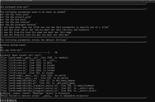

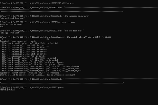

  • I don't have an nRF52820 to test on (I am on home office during the summer), and it is 3 months since this case went silent, so I didn't bring any nRF52820 devices. I tried to just plug an nRF52840 DK programmed with a standard bootloader, and it gave the response that it was an invalid object, which it is. Does the "'nonetype' to object" error come regardless whether it is connected to the nRF52820 device or not? Should I be able to replicate that error without a device connected?

  • Hi Edvin,
    1. Nonetype 'to object' must be connected to nRF52820 or nRF52833 device.
    2.You can test the nRF52820 example on nRF52833.

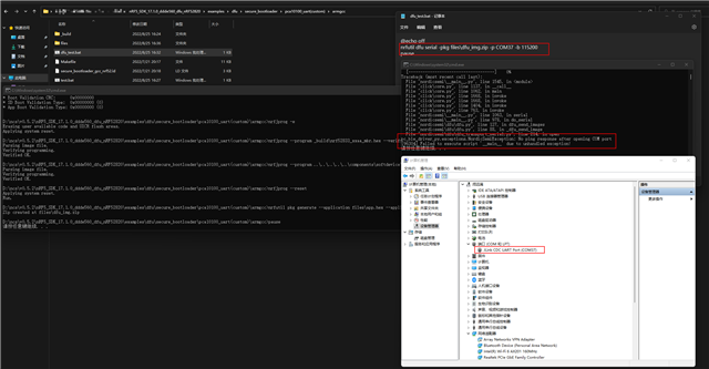

  • Hi Edvin,
    1.I test you this script does not work
    2. Note: My own UART DFU scripts are all validated and usable on nRF52840 nRF52833 nRF52832 nRF52810. If you need verification, I can send all the scripts to you for verification.
    3. It is important that you find an nRF52820 device to verify the UART DFU example.
