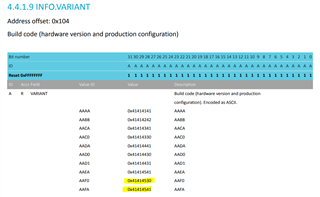

In the nRF52840 Product Specification 1.7, page 34 chapter 4.4.1.9 INFO.VARIANT, I read that the hex code of variant "AAF0" is 0x41414530. However the description says "Encoded as ASCII" and the ASCII form of '45' is letter E => AAE0.
This is confusing, especially since when I open a debug session and check in the MCU's peripherals I can see 0x41414630 which matches 'F0'.
Is this a mistake in the specification ?
Here's what it looks like in the spec :
