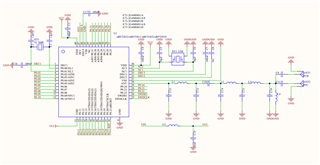

After further investigation I found out that the capacitors on DEC pins inside the module have different values than the ones in the reference circuit.
This is the internal schematic of the module I'm using.

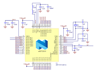

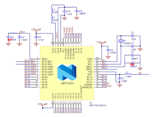

This is my design with its external passive components.
If I remove all the external capacitors I added, and keep only the C5 (1uF on DEC4 pin). Will the design be improved?
There's one capacitor on DEC3 that is far off... 100nF instead of 100pF... Which I cannot remove from inside the module. Will that cause any further problems?
    Seems like there is a deviation in the module from the reference circuitry you are using for the nrf52810, as stated in the previous Devzone thread.
    The 100nFon DEC3 is not recommended so changing to 100pF, the correct value is something I would recommend.
    So it look's like you have added decupling caps on DEC1, DEC3 and DEC4, since the module all ready seems to have components mounted internally on these pins this will result in the decupling cap values being outside of the recommended values, DEC4 is the DCDC component and for optimal performance you should stick to the reference circuit values.

  • Notice the DEC3 has an internal capacitor 100nF instead of 100pF. The manufacturer of the module have modified that value too and I cannot change it.
    I'm going to remove all the external capacitors I added but keep only the 1uF on DEC4.
    Below you can see how the schematic will look like
    So, according to the schematic there will be actually two deviations in the reference circuit.
    DEC4 1.1uF instead of 1uF
    DEC3 100nF instead of 100pF.

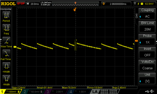

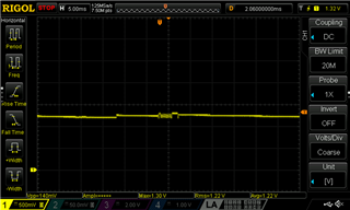

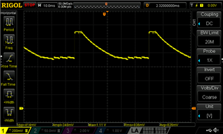

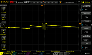

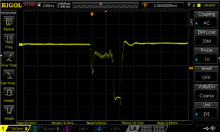

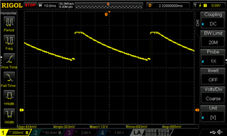

    Also, I measured the voltage on the DEC1 pin with and without the external capacitor
    NOTE: There is a 10 Ohm series resistor 1% as Rsense during the measurements below that I use for current measurement. I have already bought a PPK2 but before I got it on hands I'm trying to debug the circuit with what I have.
    2x 100nF (one internal, one external)
    1x 100nF (Internal)
    Voltage on DEC4 pin with 1uF + 100nF (internal)
    The noise in the middle is during packet transmission.
    Voltage on DEC3 pin with 100nF (internal)
    The shape during transmissions is exactly the same with the shape I measure across the Rsense (10 Ohm) during the transmissions.

    This is the LDO reference schematic                                            and here is the DCDC
    George555 said:
    Would it be better to operate the chip with its internal LDO?
    Due to your power requirements and supply it would be best to use DCDC.
    Ideally the DEC4 should be 1uF and not 1.1uF, you can try and see how the performance is but the capacitance value on the DEC pins are closely related to the regulators so changes in value will result in changing behaviour of the regulator.
    So DEC4 and DEC1 should be as they are in ref design, and you can gett get DEC1 to be as in the specs, DEC4 is more difficult but 1.1uF is better then 0.1uF. DEC3 is related to the radio peripheral so deviation on this value can change the RF performance for the worse. But it should not affect the current usage in any significant way.
