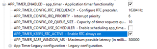

  • yes i am using ble_app_uart example , like base example.
    now it works , I enabled this option from sdk_config.h
    enable RTC always on, and now, I connect the device to bluettoh and the funtion  app_timer_cnt_fet() dont stopped again,
    I hope dont  have any problem
    thanks
  • Hi Marcos
    This makes sense. By default the RTC will be disabled when there are no timers running, in order to optimize power consumption. Enabling this option should fix the issue.
