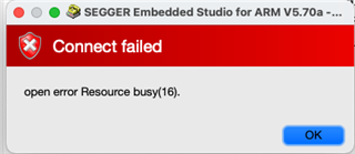

When I try to connect over UART with SES's Terminal Emulator, I get this error:
MATLAB also throws an error when I try to send some data over UART.
Any help is much appreciated.
EDIT: I found that printf() was causing problems. The code I have attached is working but I am not using DMA, but reading every byte that is entering through UART. I found that nrf_libuarte_async is the proper library for handling UARTE communications, right?
