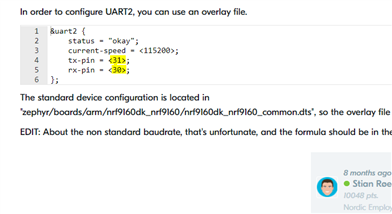

  • Hi Mohit,
    If you look at Stian answer you can see that the UART pin is configured as P0.30 and P0.31:
     Note that these pins are not connected to the interface MCU (so you can't use Real term to get the data right from the USB port of the DK). You can use a scope or connect to another MCU to get the UART data (or do a loop back).
    If you want to use the virtual COM port created by the interface MCU you would need to use uart0 instead.
    When you tested with Helloworld example, do you see the output on the virtual COMport ?
