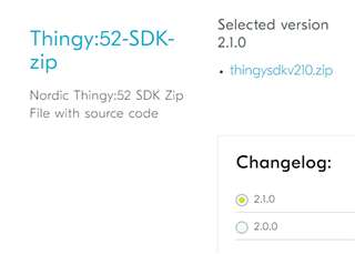

    I think you should have a look at the Thingy SDK. The Thingy52 uses a buzzer and PWM to play short sound clips. These clips are not .wav format, so I guess someone has ported it into PWM frequencies.
    There are some fundamental differences between playing a tone/note on a buzzer and playing a sound clip. When you are playing a simple tone, it is just a single frequency, but if you intend to play a sound clip, you need to use the PWM to mimic a DAC (digital to analog converter), so higher PWM duty cycles will generate a higher analogue output voltage for a short period of time. This is complex, but you can have a look at the SDK for Thingy. Find this download:
    Download it and search for "drv_speaker_sample_play" to see how it plays the different sound clips.
    Warning: This is not trivial. It is much easier to just play a few notes using a buffer.
