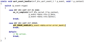

I'm testing an implementation of the serial UART bootloader for DFU. Firmware update using nrfutil works fine, using a serial-USB dongle, The only issue I'm seeing is that if the dongle is not plugged into USB port on my PC, the device will not stay in bootloader. It seems to be because the UART Rx line is low. Similarly, if it's in bootloader and I pull the dongle, the Rx line goes low and the device exits bootloader. Is this to be expected? It seems odd. I think I have a workaround by enabling the pull-up on the Rx line but it's not ideal.

    The UART transport is configured to invoke the app_error_handler_bare() function in main.c if an UART  Error condition is detected as you can see from the nrf_dfu_serial_uart.c source here:
    And the error handler will trigger system reset making the device exit dfu mode.
    A solution, as you suggested, is to enable the internal pull-up on the RX pin. This will prevent it from becoming floating when the USB port is not plugged in.

  • Thanks for the reply Vidar and the explanation. That's exactly where I put my pull-up mod.
