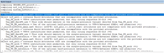

We currently have a Gazell project that runs on nRF52832. We have difficulties changing the project target to the nRF52810.
From the SDK17.0.2, example: "gzll_ack_payload_device_pca10040", just setting the target to nRF52810, we get these errors when building:
Should this even work? Doing the same with Blinky example works just fine.
    nRF52810 does not have the Floating Point Unit in the Cortex M4 CPU like the nRF52832 has. You need to use a Gazell library that is built for soft-float CPU.
    I can't find any library for the nRF52810 in the ARM directory of the Gazell library, but there is a GCC version available, which can also be used with Segger Embedded Studio (components\proprietary_rf\gzll\gcc\gzll_nrf52810_gcc.a). If you are able to port your project to one of these toolchains, you can use this library.
