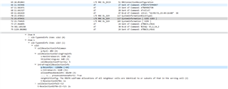

    Neighbour cell meassurements while in RRC Connected mode is decided by the network. However, if you run %NCELLMEAS while in RRC Idle, you will have a better chance of finding neighbour cells.
    However, even when used while in RRC Idle we depend on network support. If the network does not brodcast SIB3 (and ideally also SIB4 and SIB5)
    %NBRGRSRP is limited to only search when configured by the network, and will not trigger a new search when used.

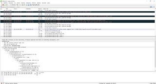

  • ing-barbiz said:
    Sure, how can I take a raw modem trace?
    Same way you took the live trace (i.e. the Wireshark screenshot you shared previously), just enable "RAW" as well (you don't actually need to have LIVE enabled at the same time, but it will lte you see what happens):
    After you start tracing, it is nice if you reset the device, so that the trace includes the modem startup.

  • Thanks for the trace. But I see that in this trace, you actually got a neighbour:
    AT_STRING <= %NCELLMEAS: 0,"0097A56F","22210","69D9",80,6354,319,67,32,192580,  6354,329,54,6,0,  77807\r\n
    I've added some extra spaces to the above response to show the neighbour more clearly.
  • You are right. This means it happens sometime. I attach here a new trace, where, according to the serial log, the radio find 0 neighbours. This was tried 10 times in a row with the same result before taking the trace.
