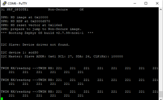

reading data from a sensor that has no driver using TWI
Hello, I am trying to read data from the sensor using I2C, I have the nrf9160 on an Icarus board https://www.actinius.com/icarus.
I tried following this guide: https://devzone.nordicsemi.com/guides/nrf-connect-sdk-guides/b/peripherals/posts/twi-ic2-implementation-with-nrfx-twis-driver
but I ended up with a lot of errors when building

actinuos_icarus_ns.overlay
&i2c2 {
	status = "okay";
	clock-frequency = <I2C_BITRATE_STANDARD>;
	/* other property settings can go here */
	twis_device1: scd30@61 {				/* e */
		// device compatible				/* f */
		label = "scd30";	/* g */
       	reg = <0x61>;						/* h */
log:
C:\Users\alnag\Desktop\Work\blinky-TWIM>west build -b actinius_icarus_ns

  • Hi, thank you for your reply I was able to find the device using the scanner and I was also able to fix the previous code and it flashed successfully, the only problem now is that the readings from the sensor are printed in weird characters  blinky-TWIM-updated.zip
  • Hi
    Good to hear you got the sensor working Slight smile
    Most likely the data from the sensor will not make sense in ASCII presentation.
    You could try to print the data as hex or int values instead. To print as hex with at minimum two digits presentation, you can do it like this:
    int hex_val = 0x12;
    printk("Hex value: 0x%.2x", hex_val);
    Best regards
    Torbjørn

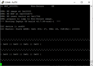

  • Hi, in the code I posted you can see that I have I2c_write_read() commented, that is because I tried using it as well, did not work with any command, however, I was able to get the frameware version ---> page 17 using separate I2C_write() then read, according to the scd30 Zephyr example:
     https://github.com/Sensirion/embedded-common/blob/1ac7c72c895d230c6f1375865f3b7161ce6b665a/hw_i2c/sample-implementations/zephyr_user_space/sensirion_hw_i2c_implementation.c
    when trying to write (Get measurement interval for example (page9)  ) I always get the deafult interval for the sensor which is 2 sec, although I just used command (set Interval) to change it 4 sec!
    when trying to get ( dataReady) it always returns 0  although I have already sent (triggerContinuous Measurement
    I don't understand where is the problem
  • Here is another example of the problem

    in this code I try to activate ASC: AUTO SELF CALIBRATION, I send the command to activate it then I send the command to get the ASC Status (both ways) and it returns 0 meaning it is not active
    I have no clue how is this happening?!
  • Hi
    Could you check the return code of the various i2c function calls to see if they run successfully?
    If they return something other than 0 it meant something went wrong in the call to the function.
    In particular the calls to i2c_write(), i2c_read() or i2c_write_read().
    Are you able to check with a scope or logic analyzer what is happening on the I2C bus?
    Do you have a datasheet you can share for the sensor, so I can have a look at it?
    Best regards
    Torbjørn
  • Hi
    they all return 0, here is the Datasheet  and unfortunately, I don't have an analyzer at the moment
