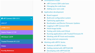

  • Hello Øyvind-san,
    When I checked last month, the page didn't exist when I selected the older version. Only the latest v1.9.1 had contents. But now there is information even in older versions.
    In the changelog, if a function is deleted, I would like you to be guided to a new function with the same function, but it seems that it is not. I'm disappointed.
    But the old version of the information helps me. thank you.
    At final, please tell me about Kconfig.
    Kconfig also changes depending on the version, but there are a lot of Kconfig items.
    There is a Kconfig list.
    developer.nordicsemi.com/.../index-nrf.html
    However, It's hard to find what I want because there are too many items on the list.
    Is there a way to search systematically? It would be very helpful if it was linked to the argument of the AT command.
    Yukio Oyama
  • Hi Yukio-san,
    The information from all previous versions of nRF Connect SDK (NCS) has been available and are available through the dropdown menu in the nRF Connect SDK part of our documentation. In the bottom left hand side of the documentation page, you will find links to the other repositories included in our SDK
    Do you have an example of what you mean with "the page didn't exist"? This is valuable feedback to our technical publication team.
    Please note that from one version to another there might have been changes to the location of our documentation.
    OYAMA YUKIO said:

  • Hello Øyvind-san,
    It seems that older versions of reference sites do not contain content before v1.3.2.
    I used to misunderstand that Modem and SDK versions would be the same. (If MFW is v1.3.1, SDK also uses v1.3.1). Therefore, I found that there is no content on the reference site of v1.3.1.
    However, it doesn't matter because the content is present in the SDK version I want to use.
    I attach an image that does not contain content.
    My question is over. I close the case.
    I digressed from my posting question, but thank you for telling me about updating the reference site.
