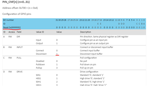

    You say you have set the TX and RX pin to INPUT_NOPULL. Can you please try to set them to disconnected inputs, which is the default state that the pins are in when you turn on the nRF. Please see:
    https://infocenter.nordicsemi.com/topic/ps_nrf52833/gpio.html?cp=4_1_0_5_7_1_9#register.PIN_CNF-0-31
    If that doesn't work, can you show me how you set the pin configuration before you go to sleep?

    Just make sure that the GIPOs that you used for the UART is also set in disconnected input (default value) before you go to sleep. (this should be done in app_uart_close()).
    If it works for you, and the current consumption looks good, then it should be ok.
