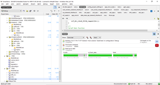

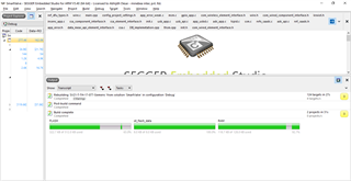

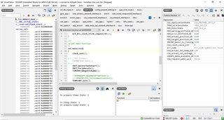

Problem : recently the debugger somehow goes to some part of code and it stops debuggiing and even debug reset doesnt work later.
When it gets stuck i cannot see rather the call stack and it stops the cursor pointing to some location in disassembly as below.
And the strange thing is it doesnt happend with release mode.
And i started facing this problem recently once i added some lines to my code and seems that if i comment any small part of code(anywhere) it works fine without problems.
Questions : 1. Is this some issue with the debugger settings?
                   2. Something related to the memory constraint? As i can see that memory is not really full and it can still accommodate RAM and Flash.
                   3. Is there any place where we have to set RAM space while we execute in debug mode?

  • Just for more information i tried to debug with OZONE debugger and found this log when ever the debugger stops.
