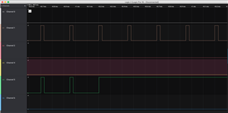

In this screenshot, there are 2 of our nrf52840 boards, each sending notifications to a phone. There are 3 GPIOs being monitored on each of our boards.  Channel 2 and 6 are being set/cleared inside of a software interrupt handler, but channel 0/1 and channel 4/5 are being driven by TIMER2 COMPARE events with the PPI.

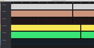

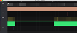

Looking closer,
We see that after our software interrupt has exited, the GPIO being pulsed by the PPI on Channel 5 has been held high for the duration of the dropout.  That pulse is normally low and the pulse duration is 30uS:
This tells me that the PPI or the associated TIMERs were stalled suddenly during the generation of that pulse.
