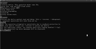

The instruction is invalid:nrfjprog --rbp ALL --family NRF91
DK:Information.
PCA10090 0.9.0 2019.21 960074892
IMEI:352656100366304
HWID:F1:7D:21:F0:45:76
Contains FCC ID:2ANPO00NRF9160
Contains IC:24592-nrf9160
C:\Users\jhfg>nrfjprog --version
nrfjprog version: 10.9.0
JLinkARM.dll version: 6.80a
step 1: Wipe the chip with nrfconnect programmer and turn off nrfconnect programmer.
step 2: Run a batch test_rbp_all.bat to intercept the picture.
The test information can be found in the annex.nrf9160烧录at_client固件 测试使能读保护.rar
Kind regards, Peter.Min
  • Hi Peter,
    We are working on a solution (updated nrfjprog), but it is not ready yet.
    There has been some discussions that this issue was not present in an earlier release.
    Please delete nrfjprog and install v10.5.0 and see if the issue is not present.
    Martin L.
