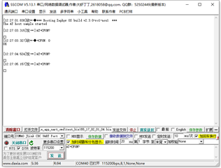

at_client routine, the test at instruction does not return any information.
Hi Didrik Rokhaug,
sdk:ncs v1.2
Routine path:D:\ncs\v1.2.0\nrf\samples\nrf9160\at_client
The routine is attached:
at_client.rar
The test results are shown in the figure below:

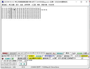

After sending multiple 0A0D instructions, the program does not return a value after sending other normal instructions again.
This error will cause the program to become stuck in the event of a serial communication program exception.
This phenomenon can cause the customer to misdiagnose that there is a bug in the AT instruction.
Please further increase the module AT instruction fault tolerance mechanism.
